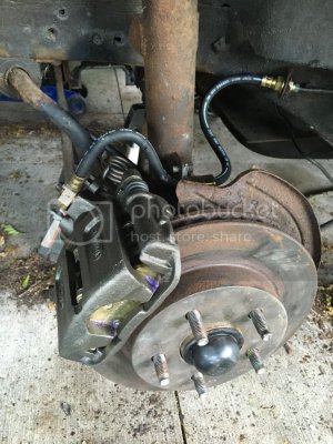

I got finished today also with the rr brakes
IMG 6888 zpsez7x1ozw
So no just wait for the lines from sho nut and hook things back up to the ABS motor..
