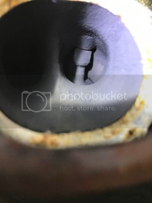

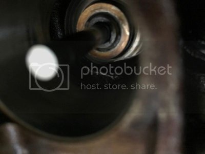

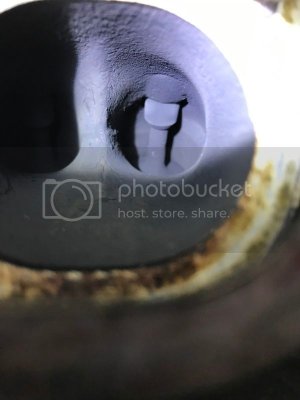

On cylinder 1 and 2, 3 out of 4 exhaust valve guides had moved. Here is a picture
"Good" valve guide. On this guide, the stem seal installed normally and clicked into place.
"Displaced" valve guide:
Displaced guide from the top. Notice how there is nothing for the stem seal to grab onto:
