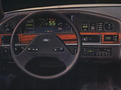

hmm, my mother had an '89 taurus lx with the digital dash, what an odd beast that '89. (oh the stories! :bonk: ) All i remember about it was that no matter how horrible the car ran (when it did), the little system monitor screen on the far left side of the dash always said "normal". :thumb:

I had an '88 Sable that had the same cluster as the '89. It was not nearly as nice and the '90-'95 cluster IMO. The speed and RPM readout was an LCD rather than a VFD and the fuel and temp gauges were analog rather than digital.

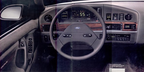

86-88 door panel pix please? You know i'm open to these experiments. Did they have the gray interior panels back in those years?
Here are the best pics I can find right now. They have the manual window cranks but if you look at the large 86 digital cluster pic you can see where the power window, power door lock, and door speaker grills go.

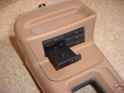

Btw, What center console would match well with that dashboard? The 93-95 gray one won't join propperly due to the lower missing radio section. Or will it?
If you want to use a 93-95 console you could get one from a '94 Lincoln Continental. They have a filler plate where it should meet the dash.
