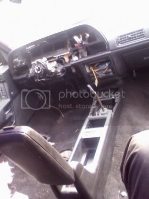

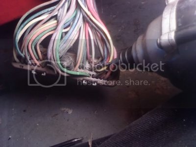

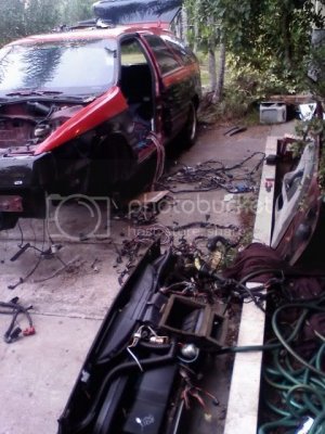

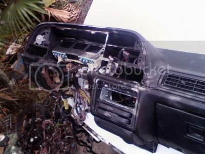

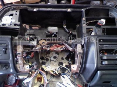

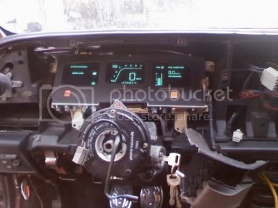

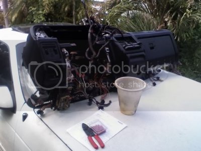

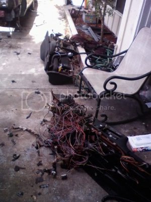

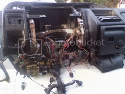

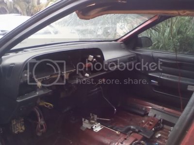

I did this project! Actually did a super major project, swap in entire sho into an 88 wagon. I did the wiring for the digital dash when the dash was out sitting on the donor sho. Project came out great. I have an actual gen1 sho wagon with digital dash. When I did it, of course swapped in a digital dash. Heres some related pictures.
[Did you install the correct wire into the ecu for the fuel computer. the The vss wire should be the right one, just tap into it and run to dig speedo.]
054
057
077
078
079
082
083
084
085
087
088
098
112
Lots more pics at my photobucket site
