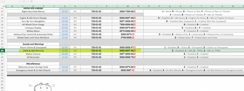

Ever look through Forscan and seeing if the setting works? I haven't tried turning on the TPMS, however it does show the current display should present the TPMS. $14/year and forums thread.

AFIAK, the IPC firmware is not capable of displaying individual tire pressures. The BCM does read individual tire pressures and can be displayed with FORScan.
I honestly do not know much about any of this subject. Does that mean that, in theory, you could take a 2018 IPC that is able to show this, and use FORScan to tell it to display this information? Full disclosure, i have never used FORScan or know its capabilities.

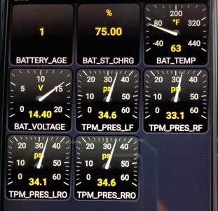

Texas is using the mobile version of Forscan on his phone, and using a Bluetooth OBDLink MX+ or any compatible version - you enter in the PID's for the TPMS sensors, and you can track this live on your android or iPhone.
We all learned by reading the FAQ's and using YouTube videos. https://forscan.org/download.html
