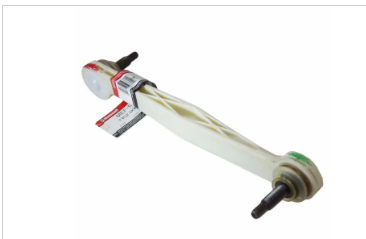

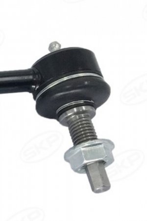

My suggestion is to get the style that is greasable and have the 18mm fitting that you use to tighten the nut. The ones that have the hex stud will always strip out after a few years of being installed.
Get this style

Not this style
