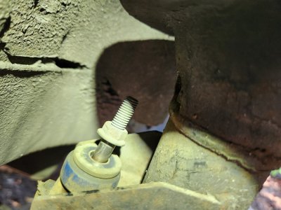

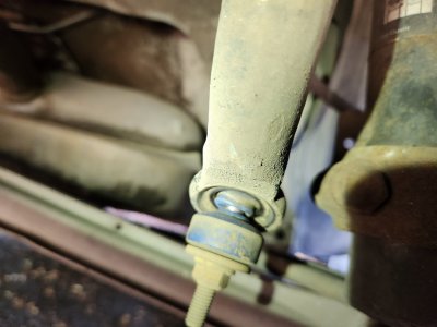

No idea why I did this many moons ago, but both sides of my rear end links aren't attached properly.
1000003771
1000003772
It looks like I don't have enough bushing or thread to tighten, and the bottom looks like it is at the wrong angle entirely. Any ideas what went wrong here?

Angles aren't always straight. Looks like the wrong bolt, too long, or the wrong spacer, too short. Should have compared them to the old parts. IMHO

There must be some other problem. The SHO source one is the same length with the TPR bushings. I probably have that unit.

Try to compare your parts with this picture. One part is wrong, it has to be one or the other. This appears to be the design you have. There are others with a long thru bolt.

Post pics of the entire link so we can see if anything is incorrect.
