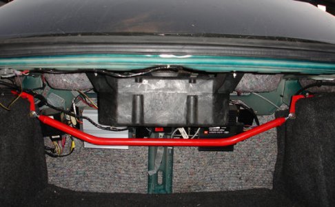

Here's the *remote* keyless entry box on my '93. It's hidden by that red thing in there, all the way to the left side.
Dsc04220
It has three connectors running to it. The plain keyless entry boxes have two, and the ones without any sort of keyless still have a relay box, it has one connector.

I recognize that box...I got one but it must just be a relay as I think it had only one connector going to it.....
