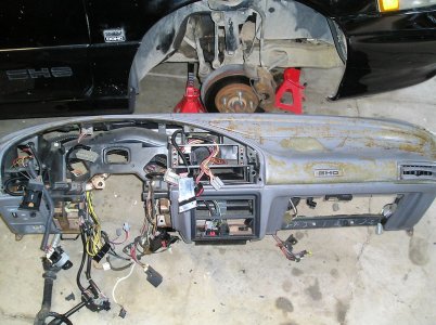

ok so i am tearing the dash out and i start taking screws out and the next thing i know the WHOLE dash is coming out wiring harness and all....I cant seem to figure out how to seperate the dash from the frame?? surely I dont have to dissconnect the all the wiring and everything right???
7,521
the dash will come out with the wiring, unless you pull all the wiring out first, which is quite challenging but possible.

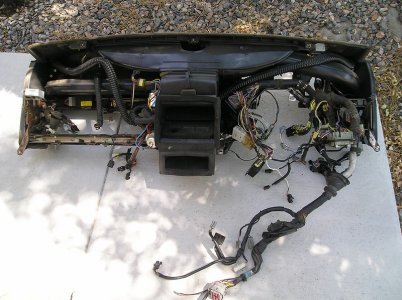

Yes, the dash, frame and wiring come out and are put back as an assembly.
7768102580 10de5403f5 c
7777571844 7f4ceeb7f5 c
All the electrical connections are down by the parking brake pedal except for:
- The power antenna (if equipped) which is on the passenger side.
- The HVAC which is on the firewall behind the glove box.
Each operation (remove, install) Should take 3-4 hours.
Don't mean to hijack thread but looking at it from this angle it doesn't look all that difficult to remove that dashboard. I have a heatercore on mine that just went the other day and need to get this done asap, is removal and install as "simple" as it looks?
intimdatr
Got Cams?
Mar 13, 2011
1,206
453
Jefferson City, Missouri
It isn't that "difficult". But it however is A. Lot. Of. Work. It will take you a solid weekend to pull your dash and do your business. It is a ton of random screws/bolts and connectors that are all in odd and awkward positions.
