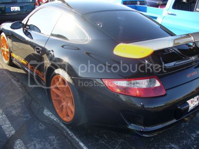

angela: i am not a sleeper guy so wild ok but those ricers are too much. last week at at a local cars & coffee & one of these were there. i know a great car & expensive but i'd take the $$ rather than the car GT3RS. just got to believe the german engineers where visiting japan & had too much sake when they did this. 4 16cofcar6 zpsqkbrz7v7
