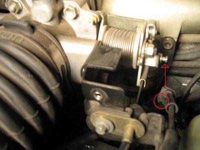

Here is a picture I just took of the TB, I'm guessing that the black box w/ the wires is the Cruise control module and it looks to be plugged in.
IMG 2088
jonmon6691
No dough SHO
Jun 12, 2008
238
19
Wilsonville, Oregon
Hey! I think i figured it out, but that leads to one more question...
IMG 2091
I'm going to see if that fixed it right now...
As for that other question, the cruise control linkage has slots for adjusting the tension, how do I calibrate that, and what exactly does that affect?

There is no adjustment required.
You've found the immediate cause of the failure. Put the cable back on and see if 1) the cruise now works and 2) if the cable stays on..
My 89's would pop off every few months....

Adjust the cruise control cable so that there is no slack when it's at idle. This will enable more precise control of speed.

Thanks everyone, this could possibly be my most money saving fix yet :evilgrin: .
Before adjusting it, it seemed to "pulse" the accelerator to try to maintain speed. But thanks to hawkeye18, I adjusted the slack and it's much smoother now.
