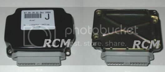

Okay what is that? And is it hard to get to?

Its a bunch of relays all put into a box, controls all the fans and Fuel pump and a couple other things.
Its the Black box on the driver side next to the radiator It will have a letter on it and you will need a working box with the same letter. Someone on the Forum should have one seeing as they are a common problem.
They loot like this:

That infamous black box!
I was able to buy a brand new one from AutoZone (specific for my ATX/year), but I still bought a good used one just in case.

If you open the box it is relays on a motherboard.

Lol same thing happenedto me I turn off the car and hear the fan running. So I see this forum and know it's the ccrm. I get out (was about to unplug the fan, thought I'd give it a try) and knock on the ccrm and the fan turns off. Lol cool
Still need to find another one now.
