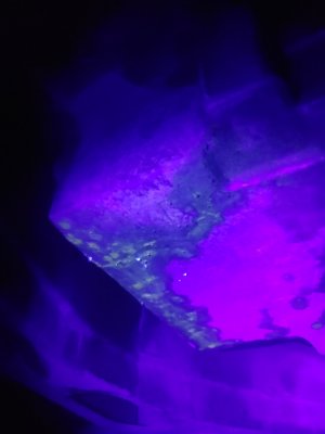

Coolant is still going somewhere. I'm adding a few oz of coolant daily. I poured some dye in the reservoir today so I'm hoping the issue will show itself tonight.

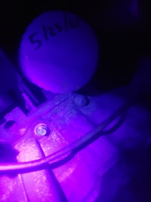

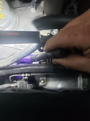

It's leaking somewhere on the passenger side of the car. The driver's side is pretty clean. I'll leave the lower cover off tomorrow and probably take the front bumper off this weekend so I can get to everything better.
20211007 19045220211007 190516
20211007 190430

Ok guys, I'm pretty sure this is my leak. From what I understand this is a "weep hole". A buddy and I pressurized the system and it held fine. It wasn't until we let the engine warm to operating temps that you can see it leaking. Does anyone have experience?

Happened on my 2013 SEL. You got lucky like me, coolant went out instead of going in. At least you won't lose the engine.

Mine was 1,800 and some change, you can do it yourself, I could have, but my hands arent reliable anymore so I paid someone else to do it.
