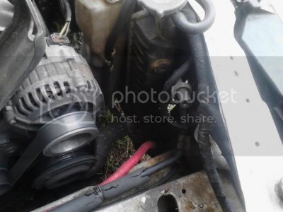

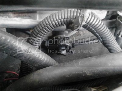

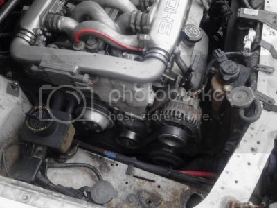

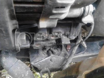

Long story short, I bought this SHO with no A/C, got tired of the accumulator and lines being in my way and hacked them out since they didn't work.
After driving/riding in other SHOs with A/C I've decided I want to try and rebuild the system.
So here's what I am working with.
IMG 20130501 100244
Crapola.
IMG 20130501 100212
More crap.
IMG 20130501 100206
IMG 20130501 100157
I am just going to presume that everything still attached is garbage; compressor, condenser, evaporator, etc.

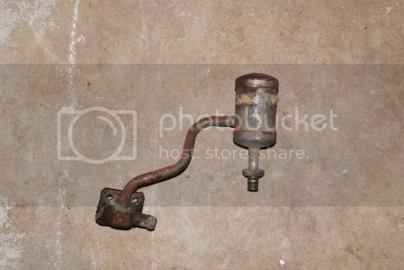

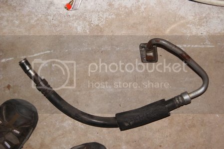

These cannot be bought new. They are your compressor manifolds:
DSC04353
^^This guy can be rebuilt at A/C shops such as ThermoKing^^
DSC04351
Make sure the above are not rusty in the interior. Anything you decide to leave and reuse, check for rust. You do NOT want rust in your system.

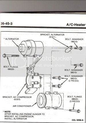

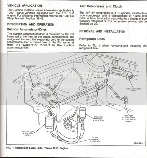

This is going to be hard to explain fixing AC on a forum but I will try.
Yes, those are the parts. But, what refrigerant you have and which refrigerant you choose to go with will decide what parts you change out. But first contact a good AC guy that will work with you and find out if he can and will recharge you system with R12, and compare the price of R12 to R134. You might want to go with R134 if you can't find someone to work with R12 or you find out that R12 is too expensive. BEFORE you work on the system, have an AC shop evacuate the system.
First, take the car to a GOOD AC shop and have them evacuate the system and maybe they will be able to tell you what refrigerant was in the system. And decide at that time what refrigerant you are going to put back in.
After you talk to the AC guy, I can give you more advise. Definitely flush and accumulator/dryer no matter what or which refrigerant you go with after that so called AC guy contaminated you system. You could have a leak or it could not be working because the R134 that joker put in became contaminated with R12 remnants or mineral oil left in the system. Attached are some schematics.
AC zpsf8b4dd75
Compressor zps3eefb639

ok, Airborne I'm hoping in the next week or so I'm trying to get this on track... I've been checking around for a reputable A/C guy that is also reasonable... After I pick my poison R12 or R134 I'll move forward, after much searching seems the R134 conversion might be the best bet, as if I need a recharge ever again might as well go R134 now, and the price for parts vs. expensive r12 will even out. I guess what I find will dictate that decision.
I will let you know about the progress and I can't thank you enough for all your input and expertise. These schematics etc are kick ass, you are the man! thanks brother!
