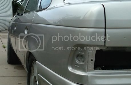

Here's how the roof is turning out. I'd say pretty damn good. And this is just a wool pad + McGuiar's Medium Cut Cleaner (O'Reilly's) after 3 or 4 passes with 1000 grit and 2 passes with 1500 grit.
...can't seem to get photobucket to agree with Paint Shop Pro that I flipped it.
Mirror 1
Still some work to do overall.
Woolmediumcutthenpolish 1

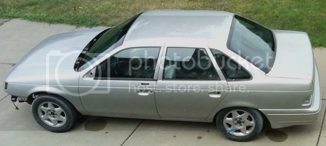

I'm done. For now, anyway. I finished up with 2000 and polished it to the best of my ability. There are still some spots that need work and I have to finish assembling it but for the first time in years...
:partytime:This 1990 SHO has a decent paint job!!!!:partytime:
Pics in the daylight tomorrow.

I need someone that knows what they're doing with a polisher to go over it once it's all assembled.
I forgot to paint the mirrors so I'll have to do that this week. I didn't take pictures of any of the majow flaws but you can see my bodywork is not so great (pictures don't show it but reflections are a bit choppy fromt he colorsanding). Maybe I'll get a bodyshop to use a 3000 grit pad on a DA and polish it. I think that would take care of some of the waves you see in the clearcoat.
