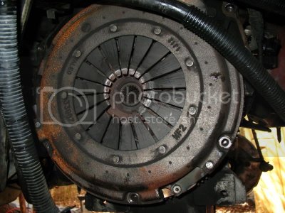

this is what my pressure plate looked like when it started doing that:
Clutchpics002
actually, mine was a little further along than yours as I couldn't get it to go into any gears at that point...
