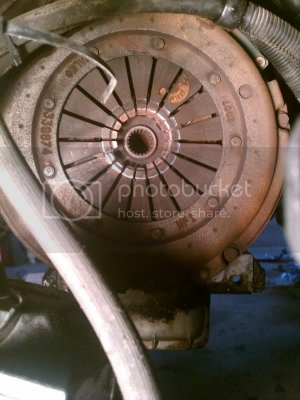

Could be a cable adjustment.
Just as likely is.... the noise you hear is the Throw Out Bearing (TOB) nibbling at your pressure plate fingers. Could be some of the fingers are already gone, and you are working on the next one in the row. Only part of the pressure plate is moving away from the clutch (where the fingers are missing, nothing is happening) so there is some engagement no matter where your foot is, in the pedal travel.

It is nothing that you did that caused this issue. The TOB runs continuously and eventually the bearing reaches its endurance limit. When it doesn't go around quite so well, the fingers see a lot more wear, and they are not too big to begin-with, so they fail rather quickly.
I have never worn out a disc, but I have gone through 3 pressure plate finger failures.
Start looking for a deal on a new Clutch Kit, I have bought them as low as $125.00 and as much as $250.00.
You still have some life left in what you have, the damage is done, and it won't damage anything else. Just nurse it along.
