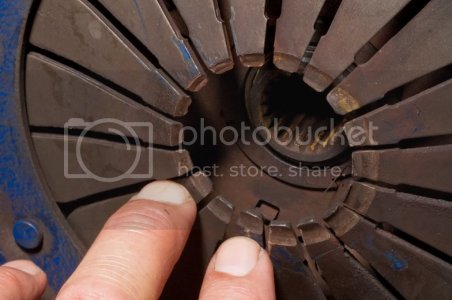

Pulled the engine.
The pressure plate springs are chewed up, and some of them do not line up with the rest. The rear main seal is leaking, the cam shaft seal is leaking, the valve covers have a great deal of blow by, the spark plug wells are clean, several electric plugs were halfway connected, but the engine was running well.
I will pull the clutch in the next couple of days, but I will put in a new one.
I have a SPEC Level II kevlar clutch which I liked very much. I'll take a photo of the pressure plate and post it so you can see the damage. It only has 30,000 miles.
I just replaced the clutch in my 5.0 Bronco II, and it did not have any wear on the pressure plate springs. That clutch had close to 100,000 miles.

I beleive that this off center wear on the springs is what is causing my clutch to engage so high on the pedal travel. You can see the uneven wear on the PP springs. Also the 2 springs I am pointing at, sit lower than the rest.
PRESSUREPLATESPRINGS
It looks as if the TOB was putting more pressure on the right side of the springs, and, perhaps, it was not spinning with the PP.
I plan to upgrade to the ceramic TOB and the teflon forks etc...
A quick look at the TOB did not seem to be worn down, bit it does make a clacking noise when you push it out and spin it by hand. I have not taken a close look at it yet, nor have I removed the clutch from the engine.
I am not in a rush, but I will get to it soon.
I plan to replace the SPEC level 2 clutch. Although, I liked the feel of it, I am a bit dissappointed with this early death.
Any suggestions with other brands. I don't drive too hard, but I drive with spirit. I am putting out 216 WHP. At the most I may consider a 5-6 lb supercharger in the furture, which I figure could add another 60 HP. But this mod is way in the back of my mind.
Any suggestions as to what could have caused this off center wear on the springs?
