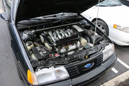

I had the same condition. My dad (from whom I inherited the car) was convinced the clutch was going.
I drove it this way for long enough that I became convinced it was not the clutch…
In the end it was oil in the camshaft position sensor. Note that this condition does not necessitate replacement of the sensor (which I initially did) - the root cause of this is the camshaft seal behind the sensor, which is a (relatively) easy fix that I have yet to do - for the time being, I simply remove and clean out my sensor with a lint-free rag, then I do the same for the vane attached to the camshaft (it helps to use some sort of bent tool, like an allen key, with a rag wrapped around it, to wipe away the oil from inside the housong, and reinstall the sensor. I do this about every 1000 milea, and when that drops to 500 I will do the seal.
