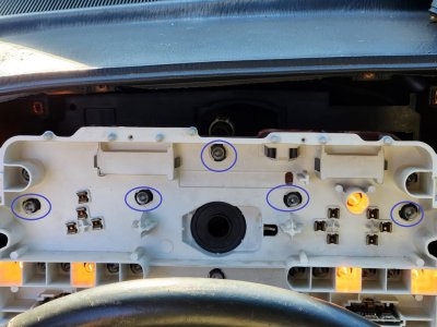

I'm having issues with the backlighting for the cluster. When the dimmer switch is clicked to the On position on a 90, are the circled bulbs supposed to be getting power? In this picture I have it clicked on, and the key is in the On position (engine off).
I verified that fuse 4 is good. I got light to the glovebox, and these ones are lit up, although I'm not sure if they are on the same fuse or not.

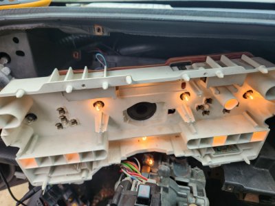

I got my hands on the wiring diagrams for the car and turns out that the issue is the rheostat. I directly jumped the wires and got 12v then tried the lights and voila.

So, anyone know if the rheostat is rebuildable, or do I need to find a used one? I tried my spare but that didn't help (which led me down the rabbit hole).

The rheostat controls the brightness of the cluster, so I'm pretty sure they are necessary. I could get full brightness by jumping it, but I'd like a functioning dimmer.

So I replaced it and now the dimming works. But then I noticed it wasn't working again and then this:

did you pull the headlight switch yet to check the connection? wasn't there an issue with the headlight switch going bad
Devin
3.Slow
Jan 15, 2003
3,542
932
Pacific Northwest
Yeah, the harness was tight. It is definitely the switch.
