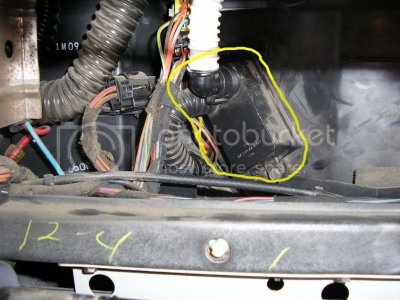

Yes - it's most probably the BCM.
The module is referred to as the Blower Motor Speed Control, which you will find referred to here as the Blower Control Module, Blower Speed Control, BCM, or BSC.
It is located behind the glove box door (lower-left corner), but accessed from below the glove box door, above the kick panel that must be removed.
Use the following dash removal guide for picture references:
Dash Removal Guide by Kurt Metros
The kick-panel referred to above, is shown in image #2 on page 7 (p.7). Remove the two spring clips (image #3, p.7) on the right and left side of the kick-panel (right - image #2, p.6 / left image #1, p.7). This exposes the BCM, which is shown in image #1 (p.8). You can also find it by following the left flexible hose from the A/C Automatic Temperature Control Sensor (circled in yellow in the image below), which connects to the BCM:
BCM
