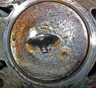

Here's what can happen if the valve sticks open because of carbon buildup. A catch can stops this buildup from forming.

That's scary. anyone know of a great write up for a catch can? Not real expensive but real easy to do and a great spot so its not noticable.....have been wanting one for awhile hopefully when the sho breaths again. I can put one of them on.
