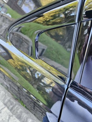

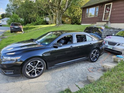

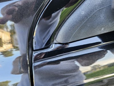

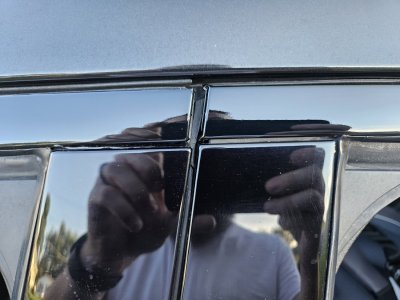

So I went right ahead and purchased the pre cut ebay shit. Ive never done custom vinyl and i have a little bit of OCD.
I started with the hardest part, the corners. Because mechanic rules are "hardest part first"
Mistake.
But it's on. It's done. It actually looks great. One corner I may just buy a wide vinyl and custom cut it on the car. And then do the other corner.
We typically rate paint jobs by feet.
I'll call this an extra observant 5 footer. Regular person 2 footer.
10 feet it looks factory.
Maybe I'm I'm nitpicking. Being too critical expecting concourse on a job rife with compromise.
