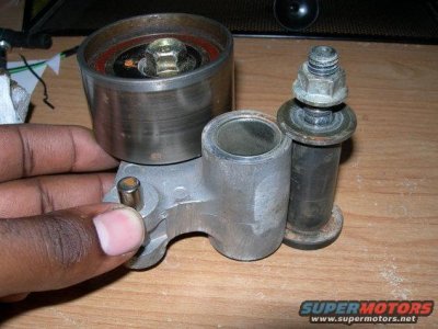

From what I remember taking off the accessories on my 3.2L before I put it in my 92, the tension piston does go in the notch, and the washer is way too big if it has a radius of 3-5cm.
Give me a few minutes while I go take a quick picture of the parts in question before I ship them off...

Dscn0782
Here you can see where the piston fits into the notch in the tensioner pulley and arm, as well at the size of the washer.

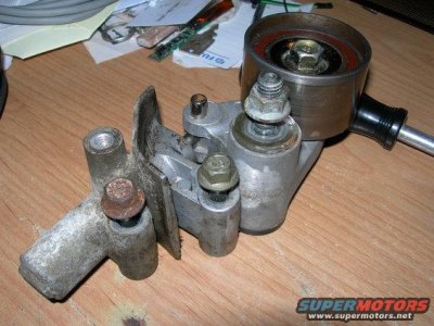

Dscn0783
In this one, you can see the bushing sleeve, the washer again, and the nut and stud.
As always, click for hi-res version. :)

That's how we have it. Thank you very much for posting the pictures :hail: , if nothing else it's just reassuring that we got it on right.
