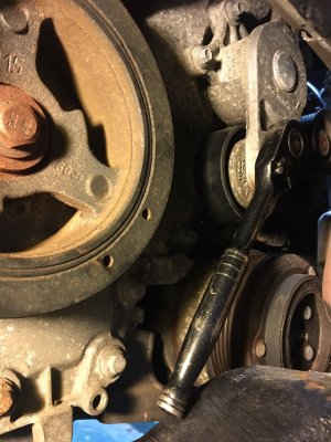

Anyone done a write up on changing that belt? I should do mine and it looks like a bitch. Have not looked from underneath though.
Belt is very easy to do from the passenger side wheel well.
I changed mine when I was replacing my PTU. I think I have some pictures on my phone.
glockcoma
Jul 25, 2016
339
418
47bb942c67ae607b3926e0adfee18a19
This is the only pic I have unfortunately. Just use the 3/8 ratchet inside the tensioner arm and pull clockwise to release the tension on the belt.
it only goes over three different pulleys since we don’t have a power steering pump.
