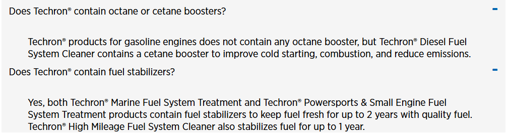

Yes, Techron is a PEA-based fuel additive. It is a product of Chevron and is widely recognized for its effectiveness in cleaning fuel systems and removing carbon deposits.
Techron's active ingredient is polyether amine (PEA), which is a powerful detergent that can break down and remove carbon deposits from various parts of the engine, including intake valves, fuel injectors, and combustion chambers.
Using Techron can help improve engine performance, fuel economy, and reduce emissions by keeping the engine clean and free of deposits.
