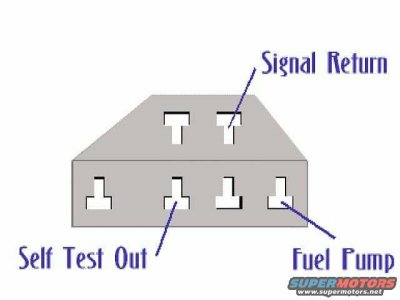

You can force the fuel pump on by shorting a pin to ground with the key on. If it does not come on then there is a wiring problem between the CCRM and the fuel pump. Could also be the roll over switch.

Did you try grounding the fuel pump wire with the key in run on the underhood data link connector?

I believe so. I connected the paper clip to the two ports you labeled on the diagram, and turned the key on, which resulted in nothing. I am pretty sure its some electrical issue between the relay and whatever that relay happens to control. As I stated before, when an OBD-I scanner is plugged into the "data link connector", the scanner appears to lose it's ground when the ignition is turned to ON. The harness connecting to the CCRM has probably seen better days, but I'm not even sure what each wire is. Is there a wiring diagram available?
On a side note, I'm replacing my front valve cover gasket this week, so any ideas as to how I can further troubleshoot this problem is appreciated. Thanks so much for all your guys' help.
*Update* I realized on pheonix project that the grey separate connector is the ground. I did the paper clip test again and still no fuel pump. Also tried the code test and nothing happened. I did disconnect my battery, but even if I cleared the system shouldn't the check engine light blink continuously?
