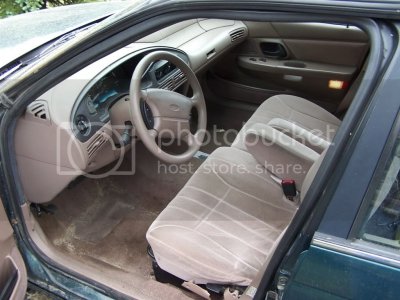

heres the slo

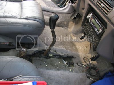

heres the sho and the hole you'll have to cut, i have heard mixed things about replacement carpets though and their fitment....
