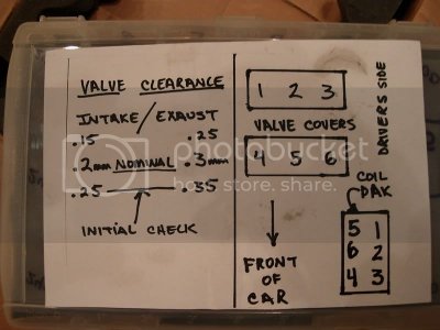

Here is a wire diagram from my Shim Kit-
DSCN1015
After fuel pump primes check fuel pressure at fuel rail valve-should get a fair squirt. Chek DIS is comp. connected & WELL grounded,check path or add a wire from firewall to rear lower DIS screw. Did you replace CPS while you were in there? Did you gap it right? Check for tach moving as you crank it.
