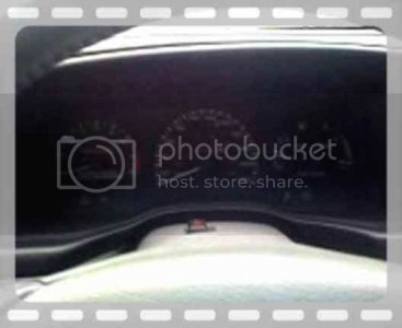

As you can see in the video, as soon as I turn the key to start the car, I'll lose all power and sometimes the starter will click, as you can faintly hear. Most times after trying to start it the clock will reset to 12:00 and I'll lose all radio pre-sets. If the key is in any other position I have normal power to everything.
Th  IMG 0030
It did this a couple months ago so I checked the ground on the fender, cleaned it and re-attached it and also replaced the starter solenoid. It's been fine since, but now it's doing it again. Does this sound like a familiar problem? I can bump start the car no problem, but really hate doing so. Battery is fine, checked with voltmeter and also checked the alternator when it was running and it was putting out over 14 volts.
I've read from past threads it's most likely a grounding issue, but I only know of the ground on the fender, and it's fine.
Any help is appreciated :thumb:
