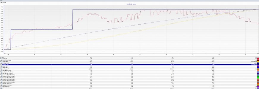

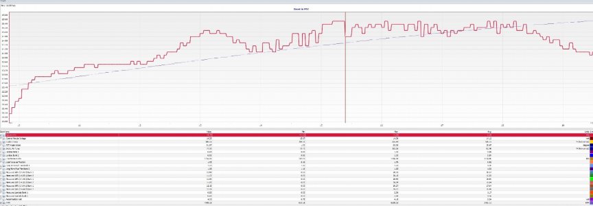

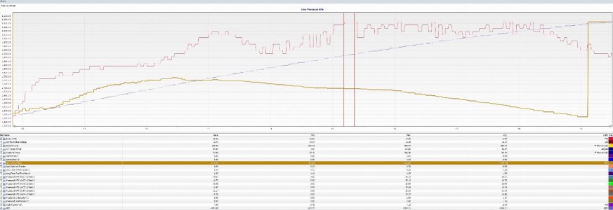

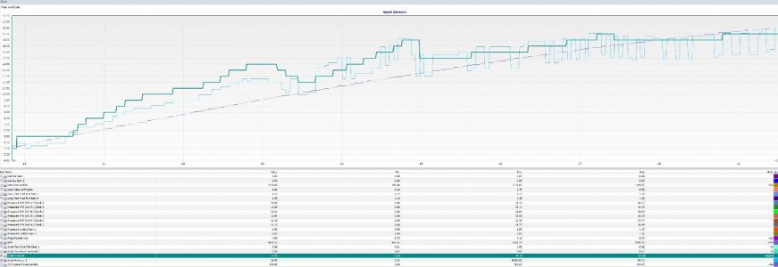

Went out and did a datalog on the SCT. IAT was showing around +10F over ambient.
Here are some pics from it, if you notice anything that looks off, let me know. I broke it down so it is easier to compare data points.
Boost over RPM, all runs are same data from 2200 to 6200 RPM. Seems to be between 13 and 15.5 psi throughout the pull.

IAT over boost, coolant and RPM.

Line Pressure kPa over boost and RPM.

Spark advance over RPM.

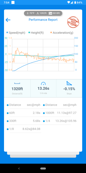

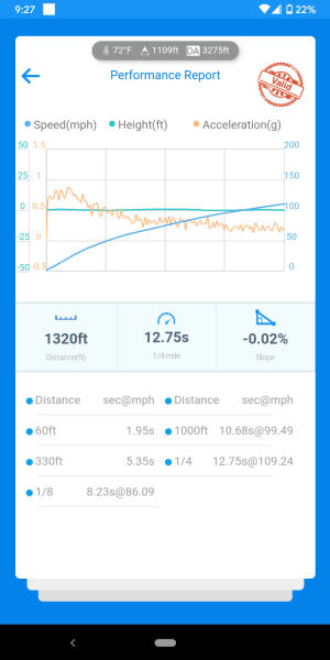

Finally, my disappointing Dragy runs from today.
Chirped the tires off the line on the first run.
51095316077 0b4ffce3b0 o
51095764773 47fc757f99 o

Your DA is even higher on the latest runs at 3k.
