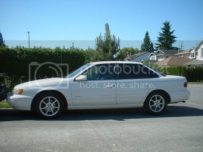

Do you have any pictures of them installed? Also, how many miles/how much time have they been on the car?

Considering you had them on a SLO, on a SHO (especially an ATX), it'll sit significantly lower due to the increased weight.
That's what I want to hear. Hopefully It will sit 2" lower.
I did notice that the drop you get with lowering springs will depend on the strut you use as well. The Sensitracs have a slightly bigger (1/4") distance between the strut tab and the spring seat vs the stock struts, so I cut the tab down 1/4" on the Sensitracs before I installed them on the SLO.
