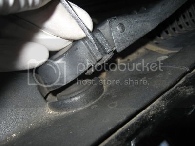

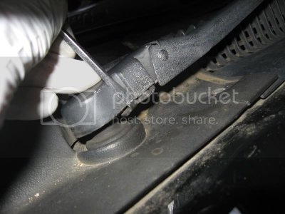

They can be a PITA. Keep the arm about straight. Use a small screwdriver on the latch as shown to release the arm, and then lift it from the splined shaft.
