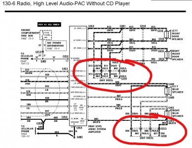

If you look at this diagram there are 2 sets of speaker wires in our cars. One set goes from the amp to the speakers. The other set goes between the deck and the speakers. The latter are not used in the SHO, but have been installed anyways. The standard plug utilizes the the wires that run from the deck to the speakers (labeled "not used" in diagram). If you use the standard plug, make sure to use a head unit that has an internal amp and unplug the stock amp because it is no longer used.

Match the colors and connect the wires of the standard ford harness to the aftermarket head unit's harness. Unplug these 2 connectors (circled in the picture) and plug them into the other end of the standard ford harness. Plug in antenna connector. Unplug the connectors on the factory amp. Mount head unit. Enjoy music. It's that easy.

Thanks, a picture is worth a thousand words (and a wiring diagram!)
