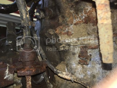

Anyway...Kevin...are these the two bolts you're talking about to fee the tranny from the short block??

jeez, what a mess.
no, the bolts go horizontally from the pan and thread into the bell housing, toward the bottom of the pan, iirc.

Great Great!!! Thank you both...Tomorrow,I'll get off the intake and the tranny and then report

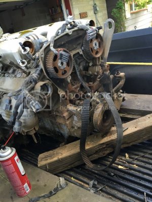

I think I'll also have a shot at the crank bolt and see if I get any movement...if not...maybe get the tranny off and then block the flywheel,,,
Judging from how the crank turned and looking into one cylinder, I didn't see any red flags yet, but I'm working on getting a hoist so the get the pan off and see the crank and rod bearings
I bet if I loosen the winch strap, I can kinda lift the front of the engine and then let its own weight down on the crank pulley, Maybe that'll hold it, I've got a pretty good electric impact..

I got the tranny off and slid it down two 4x4 posts onto a dolly...Intake came off nice and a couple of the plug wells were shiny, nothing terrible really. I've been cranking on the crank bolt, I think it moved a little, but I'm gonna give it a rest. Can you guys tell me more about the heat idea. ...I know you torch it for a half minute or so...and then do you try the impact while it is still hot...expanded?? that seems like asking for trouble....or do you wait for it to cool, the idea being that it has expanded and contracted micron and then may release??/

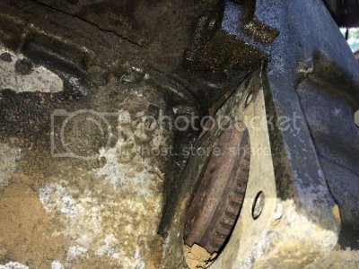

Someone had already taken out one of the horizontal bolts and someone tried to get the tranny off a while back and chipped the two lower mounting holes on the bell housing, I...got all of the off except one on the far right, I guess I wasn't patient enough or it was weakened by rust...anyway, I broke off one bolt head, so that'll have to be tapped out I guess to re-use this bell housing...
Does the throwout bearing have a cotter pin or something that is supposed to go through the shift fork and into that bearing?? Cause there was nothing there..Seems like there's need to be a pin or something...maybe that's what happened?? The throwout bearing cam loose and they tried to open up the tranny to fix it and then after breaking of two small places on the bottom edge of the bell,,,,they gave up...just guessing of course...

No cotter pin, there's a small plastic that is used to hold T/O bearing in place during assembly. Not necessary for bearing operation.

Black dirt may be a sign of normal clutch wear. You don't know how the car was driven before, i.e. slipping at start, trying to do burn outs. Any sign your input seal is leaking.

I have a craftsman breaker bar, and a 3' piece of pipe I slip over that to get things like crank bolts loose. Use a 6 sided socket and be sure it is all the way on, because I have seen crank bolts that were rounded off by people who were not paying attention... An assistant holding a large flat screwdriver in one of the teeth of the flywheel/flex plate will hold the crank from turning.

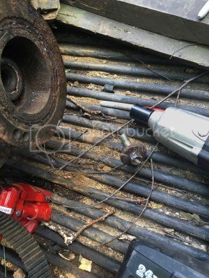

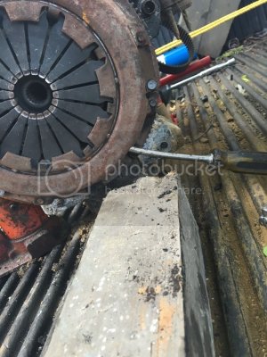

Ain't got no assistant...:-((

So now, I have to get a harmonic balance puller right??

If you can't borrow a helper maybe you can travel it to or have an air comp & gun brought by for a quick hit on the crank bolt. Otherwise you have to jamb up the flywheel somehow. Pain in the butt. A quick shot with air gun moves it out. You try the electric impact on the fluke it might work?

Hey...are you talking about getting the crank pulley off?? I don't understand your explanation but I really want to, can you explain like you're talking to someone who has never done it before. I watched someone do it on a little motor once but it just popped off with a couple hits from behind... thanks in advance,
T
I can for sure jam up the flywheel...this held it for me to get out the crank bolt...although the screw driver is useless now..

that screwdriver is still very useful, for example when you want to tighten the crank damper pulley bolt...

Talking about the seal around the splined shaft of the transaxle. If it is seeping at all, the trans fluid combined with clutch disc dust can make a mess of the inside of the bell housing.
