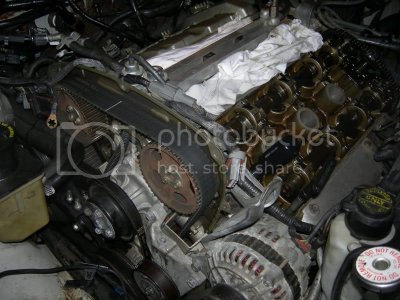

Ok in my other recent related post, I'd begun this project. Turns out I don't need the 60k kit as I've pulled both valve covers and found all of the valves to be in spec. The damaged shim will need to be replaced but that won't require the tools since I have to replace that camshaft anyway. I went ahead and put plugs in and new valve cover gaskets, and I'm also going to replace the intake gasket (just the one where it seats to the engine for now).
As of now, the plugs have been installed, valve clearances have been checked, and valve cover gaskets have been installed (only the rear valve cover has been reinstalled on the car). All I have to do now is the direct camshaft swap and replace that one shim.
Here's a photo of what I have all cleared out and ready to replace it.
60k5
I'm worried about stripping those 3 sprocket bolts since I've done that at the j/y before. I'll find the timing belt tensioner, line up all my marks and go from there. Spent probably a good 7 hours on it today but took my time. My brother helped out alot, and I went through and wiped stuff off, torqued the plugs to specs, etc.
We'll try and get it finished tomorrow if we have another shim of the right size. I'll be nervous putting it back together. Working around that firewall is a royal PITA and it took several tries to get that rear valve cover on because it kept screwing up the gasket. I figured out the trick to getting it back on right though. The stupid bracket that has to be kept (the one with the grounding strap) was also a nightmare. I am leaving the other brackets off since they're pointless.
