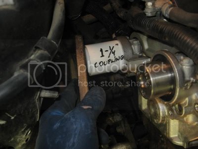

I have had success tapping the seal in place using a 1-1/4" PVC coupling and a flat steel bar for a hammer. Of course, the Rotunda tool is preferred. It's important that the seal goes in square; it will try to go cockeyed as it goes in. Be patient. I stretch electrical tape around the end of the camshaft to protect the seal lips during installation. Put grease on the lips, and RTV around the outer perimeter. The National seals are the only ones I've heard consistent positive reports on, aside from the now-unobtanium Ford seals. NAPA does not make seals; you may be able to look at one of them with a magnifying glass and see the lettering to determine which manufacturer they are re-branding.

yep....thats how i did it! Thanks for the help and pictures. Any chance you have a picture with the engine at TDC with the cam position sensor steel sensor wheel ..........i am unsure if it got it right. i may have it 180 out.
