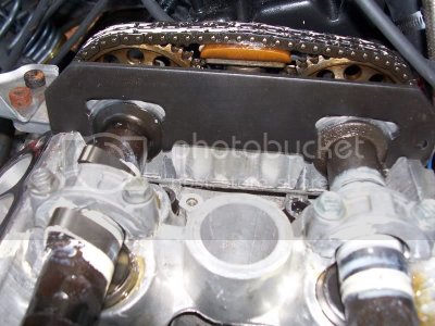

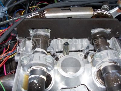

I have made so many SIMPLE mistakes on this build thats its getting to be VERY frustrating. I found part of my rough running engine.... Good thing I decided to re do all the timing from scartch. The cam that is off runs the CID so It was realy screwing stuff up.
GOOD
100 1201
NOT SO GOOD
100 1202
