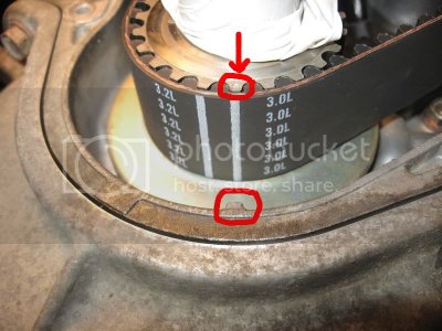

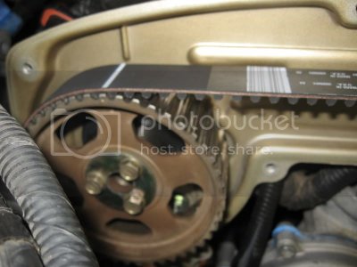

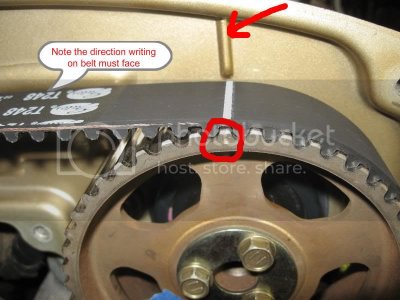

The reference dots on the sprockets line up as in the pictures. The white lines on the belt line up when the belt is first installed, but begin to "march" as soon as the engine turns over and you won't see them aligning after that. The dots on the crank sprocket and cam sprockets will always line up with their respective reference marks, when the crank is positioned as in the pictures. Note that if one is wrong, it's going to be at least one tooth off so it will be fairly obvious.

You know that Cyl 1 is at TDC when the punch mark on the crank sprocket is at the mark in the 5 o'clock position. The cams are timed properly for this when their marks are at the 12 o'clock position.
When you install the belt, just make absolutely sure that the 3 marks on the belt are lined up with the marks on their respective pulleys (as shown in the post above), and you have it correct.

Maybe not. Looking at the pics up above it seems that the crank has moved after being tensioned. Look at the belt marks in the first and last pic. The 3.2 is facing straight down at the 6 o'clock position in the first pic and in the last it's moved towards the 7 o'clock. It makes sense the crank would move after being tensioned because all the belt slack is there and there is no slack between the cams or the front cam and the crank. Any and all slack is between the rear cam and the crank and once the tensioner is released, the front cam is what sets the tension so it should not move at all but the crank will just a hair while the tension is being set.

When the sprockets are positioned with the dots aligned for belt installation, the rear cam is positioned with one of its lobes straight down on a valve. It's quite unstable there, and will sometimes snap itself out of position from the valve spring force. Then you have to realign it. After installing the belt and releasing the tensioner (leaving the lock nut loose), let the crank rotate clockwise just enough so that rear cam is in a more stable position. That is what you see in the last photo. All alignment is still correct because the toothed belt moves everything in synchronization.
The next steps are to finish up the tension adjustment procedure, and verify index mark alignment is correct, as instructed in the FSM:
  1. Install lower timing belt cover
  2. Install crankshaft damper (pulley)
  3. Rotate crankshaft two revolutions in the clockwise direction until the yellow mark on damper aligns with 0 degree mark on lower timing belt cover.
  4. Remove plastic door in the lower timing belt cover. Tighten belt tensioner lock nut to 33-51 N-m
    (25-37 lb-ft) and install plastic door.
  5. Rotate crankshaft 60 degrees more in the clockwise direction until the white mark on the damper
    aligns with 0 degree index mark on lower timing belt cover
  6. Ensure index marks on camshaft pulleys align with marks on rear metal timing belt cover.
The reason for this is the belt has the most slack at 60 degrees BTDC, and that's the point where you want to secure the tensioner lock nut.
