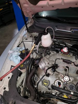

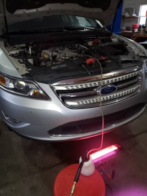

Mine was full of oil from the engine I replaced with blown turbos. I heated the CAC with my IR light, sprayed brake cleaner in the driver side CAC intake and vacuumed out using my brake bleeder with car tilted to passenger side a bit. I bore scoped it before and after. The heated brake cleaner cleaned up things nice. I got about half a cup of nasty oily stuff out.Eddcf2ea65f465c4f5cab8ca6afe58fa9a99c4767c0545a9529a4a644eea7e7b

whats that red plastic thing with black cap on back of motor? Also what symptoms or codes did you get to know the turbos were blown?

That's my Milwaukee cordless ratchet. I use that thing a lot. The turbos were dripping a lot of oil externally and also pushing lots of oil into the CAC and intake piping. I am looking into rebuilding them. Since the impellers look good I think I can replace the floating bearing, reseal them and the balance should be good.
