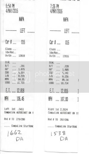

I ran the MKS at Brainerd last night hoping for a new personal best time but did not get it. DA was in the 1500-1600 range - typical for Brainerd. Coyote Mustangs and Challenger R/Ts were in the 13 second range so I don't feel too bad. My car seemed to pull ******* the low end but sort of lay down at high RPM. It was pulling timing and I was seeing KR at WOT. I had never had that before. I likely needed higher octane fuel or just go back to a bit less aggressive tune.

Whatever else it might be, can't say you are not consistent, Bruce! What octane fuel were you running? Any E85 mixed in?

I was running 3 gallons of 102 racing fuel mixed with 9 gallons of 93. Honestly, I am not sure of the quality of the racing fuel that I used. I was trying a new tune that my friends at Livernois sent me. My car seemed to like it up to about 5000 RPM but didn't seem to like it at higher revs.
The SHO was tuned by Unleashed he was running Meth. He ran a 13.1 to my 12.8. He didn't think his meth was operating correctly. Once he gets it sorted out, the results could be different....
