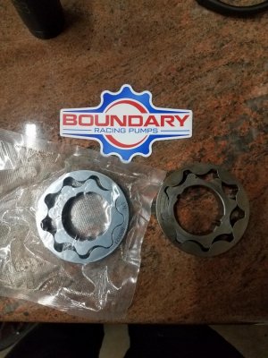

05/28/2020......
Boundary Racing Billet Oil Pump has arrived!!!
Also went one step further, and had the "WPC Treatment" applied to this piece as well.
No anticipated oil starvation events thanks to this product.
Hope everyone's well and slowly getting back to normal. Whatever normal may be of course.
Now if someone can just convince that stubborn Governor over yonder in Michigan to stop repeatedly extending the "stay at home/shut down" orders, maybe my transmission vendor can start receiving parts deliveries and finish up my custom trans work sometime in this lifetime!
Fingers crossed!Cdb867e96d84ae71945b01cf766ffd79

I have these OPGs as well. Beautifully machined pieces.

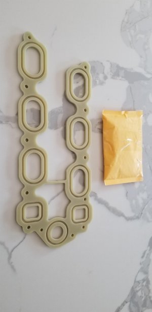

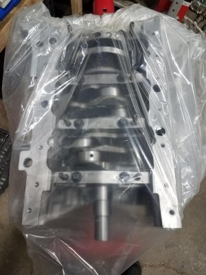

06/10/2020......
My longtime mechanic friend said he's recently spoken with the transmission vendor. Work is nearing completion. So much so that I was asked if I had a color preference (if any) for the casing.
Also, received an update from engine builder today as well, along with a few pics.
More parts have finally returned from the vendor performing the "WPC Treatment", and as such, more assembly work on the motor has commenced......
New crank (WPC'd as well) installed. Said it spins smooth as butter.
Head bolts properly installed, torque'd etc. (unlike how "L" had them installed, with outer's double washered, inner's no washers at all, what a joke).
Pin on the left is WPC'd. One on the right is factory new/untouched.
Wanted to share the progress. Get'n there. Little bit at a time.
