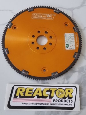

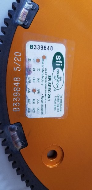

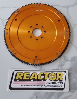

On a good note though, the vendor handling the upgraded flywheel emailed me this morning, providing an update that the newly fab'd flywheel has been sent off for anodizing and should be completed in its entirety soon!
