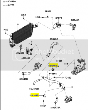

Nice. I guess I can still say I have never owned a turbocharged car with a maf sensor. The last 5 all had map sensors. Do you know if each turbo has a surge valve?
Each turbo has a bypass valve PCM controlled.

I have actually been researching this topic for a lil while now and have came up with a custom setup I am going with. I wasnt going to say anything til it was complete and able to do a write up on it but sense this subject came up let me try to clarify the factory setup.
There are two recirculation valves, but, are both on the rear turbo's "hot" pipe. And it is a MAP setup which was previously stated, which means RTA BOV's dont hurt the car at all. Below is a schematic of the factory system from the turbo's to the throttle body. The recirc valves are highlighted in yellow.
