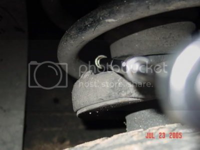

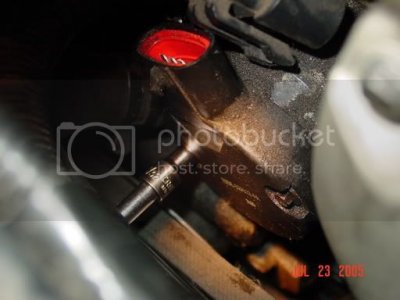

i found a really really easy way of doing the back bolt on a MTX.... well actually, you can do both bolts, just need a swivel...
you need atleast 3 4'' 1/4 drive extensions. what you are going to do is look into the passenger side fender well, the is a hole. the best way to spot it is to put a shop light in the engine bay, mainly on the cam sensor. take a look into the fender well.... you will see the hole, and the bolt...take your contraption of 1/4'' drive extentions, and put it through the hole, and go into the engine bay and line it up with the bolt. Its kinda hard to get the drive on it from the fender well, so just hold the ratchet, and lean over the fender....
for the front bolt, just put a swivel on the end. you have to angle the ratchet that way.. of course...
but you get the idea...
This is ALOT easier than trying to get on the front of the motor and the strut tower.
there is really only enough room in there to move your hand around, which with this method, that is all you need. Just to place the sensor in there, connect the sensor, put the bolts in, (or you could put them on the drive, either way) and thats it... no more foul language at that sensor any more...
i have yet to try this on the ATX but, it might work... BUT the sensor is alot easier to get off on the ATX....
Enjoy!!!
SASHO91
Zoom Zoom
Feb 3, 2004
6,990
141
San Antonio,TX
here are a few pics....
DSC01077
DSC01073
DSC01072
I dont know if GI guys can do this, as i havent worked on a GI.... but if the motor sits the same, which i think it does, it shouldnt be a problem... unless that hole isnt there.....

you think thats nice...
could you imagine the look on my face, and the feeling i had after 30 mins, of trying to get my habd in there, and turning that ^$$%^#@@^@^%^$@#!@%#^$%^ little bolt.....
:laugh_ti:
yea.... this one helps out alot....
