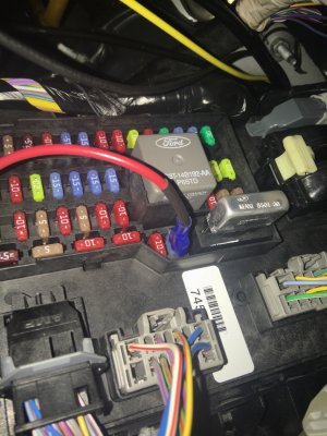

The problem now is finding a fuse that is "ON" in the On, Run, and Crank position for the Boost Gauge. The W/M flow gauge is full operational but Boost gauge is not. It powers but does not read boost or vacuum. I tried F46 in the BJB where my methanol kit gets its 12V switched power but that doesn't work for the boost gauge. When the constant 12v power wire (red) and switched 12v power wires (pink) are both hooked directly to battery both gauges work flawlessly so I know this is the problem.
Anybody know of a 12v switched power supply in Battery Junction Box besides or Smart Junction Box that is "ON" in the On, Run, and Crank position?

Pin 39 at conector c2280b (vt-gy) is the pin for disabled backlighting. This also goes to the headlight switch.
No garuntee that it won't trip the FET.
As for key on power a test lamp will get you what you need the quickest

69
22fc92895aa357ef1241bf99b1fa45c1 this is key on hot if you haven't figured it out yet. Currently using that for my meth controller
