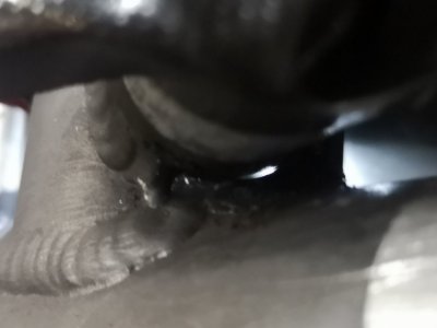

Now for the bad news. Unfortunately the charge pipe with the **** off valve mounts has a faulty weld and is leaking form a pinhole. I will have to wait till tomorrow to hear from Lee or EcoBoost performance on what to do about this. The weld is in a spot that's hard to get at so it's just luck of the draw that it happened to be leaking.
Here's a picture of the Gap I found that was leaking.

So I ended up ceiling up the leak with black RTV silicone. Apparently EPP is where the problem is going to try and see if they can rectify it on later runs of the parts. Cross your fingers.

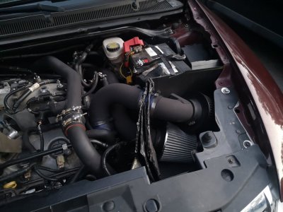

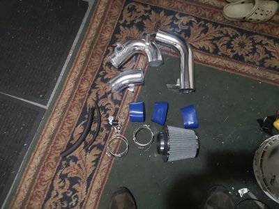

For the long weekend I've picked up a few odds and ends to try and make my own twin filter intake for the MKS.

Okay I got the dual intake installed. First thing I discovered was I have a **** off valve that wasn't sealing properly. There was a small imperfection in one of the seals. I swapped in my spare set of **** off valves from the parts car stash. I dropped .2 off my 0 to 30 and .4 off 0 to 60 time. I did a log of my runs. With traction control on there was a lot of wastegate fluctuation in lower gears with a slight chirp at takeoff.
With traction control on there was a single wastegate opening right at the start coinciding with the chirp of the tires on takeoff. I was pushing 14.8 PSI by the end of first gear. So I need to start practicing my take off to avoid the chirping of the tires on lunch. I'm going to have to see what I can do with tire pressure and possibly swap the MKS rear shocks back in. They have more low speed compression dampening then the SHO shocks. So this should help control weight transfer to the rear on launch.

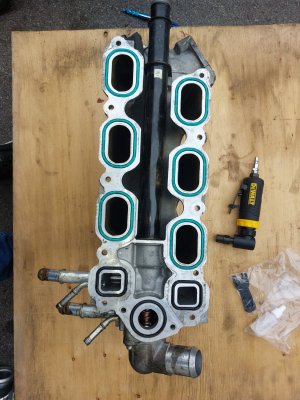

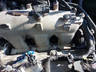

More redneck enginerding here.
I never liked how much the hot20210915 170703coolant pipes heated up the intake. So I looked and thought it said take a stab at separating thermostat housing from intake manifold. Once I get it back together I'll find out whether or not intake temperatures are lower.20210915 160804

It's not an easy job it's tight in there. Have to watch it for core shift as well as these are castings.
I thermal coated and Heat cured underneath the manifold and the surface of the thermostat housing.
Worked at a research lab once for a short while doing stuff with thermal coating durability and heat transfer properties.
So we won't find out until tomorrow how it works.

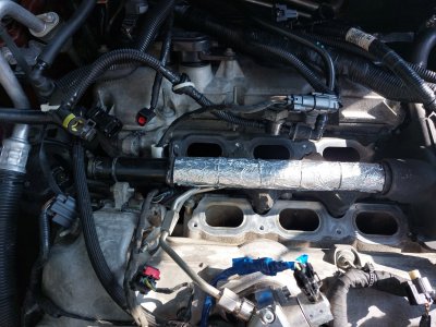

Okay I got the manifold installed today.
I took a little drive around and check temperatures. Heat soak seems to be about the same. Maybe 2-3°F cooler. Temperatures while driving are 10-15° cooler than just with the Gearhart intercooler. With a best of 17° over ambient while driving. Intake temperatures fluctuate with throttle opening, but I cannot remember if it was this rapid before or not.
I suspect a spacer would drop temperatures even more.
Tha inside passages are ceramic coated as well.
Not as big of a difference in temperatures as I had hoped. It was 78° out.
