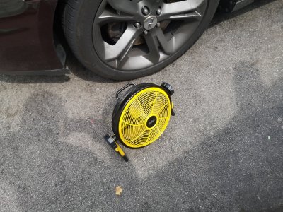

I picked up this battery powered fan yesterday to use at the track between runs. Jordan told me running a fan can help cool the intake between rounds.

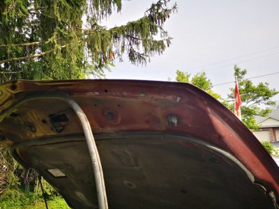

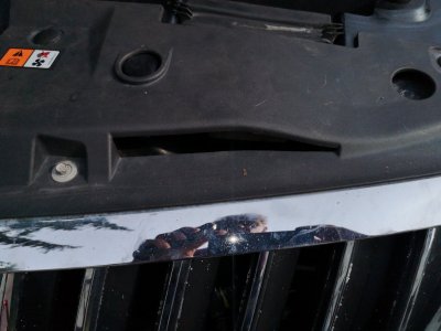

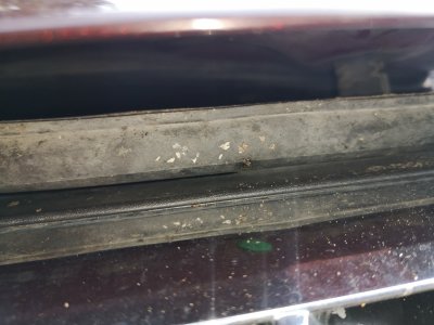

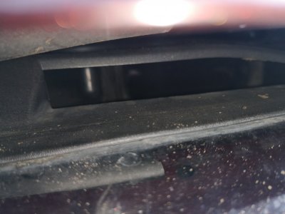

On a lighter note. I had the hood up on the car and I noticed something I usually catch on to right away.
There's a weather's seal on the leading Edge of the hood. Now the cold air intake, takes in air in front of the air conditioning condenser. But it's bifurcated so that half the intake takes air from that point and the other half takes air from above the filler panel. So I partially closed the hood and realized the weather stripping was blocking half the airflow. I trimmed the weather seal up and now air can be taken from the top half the cold air intake.
Pictures of the air and take with the hood not quite closed. So open about 2 or 3 inches.
