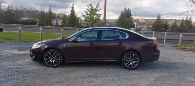

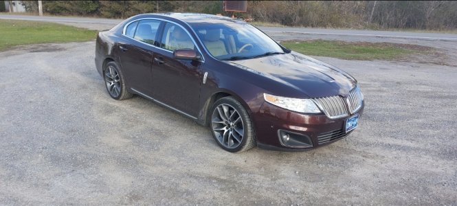

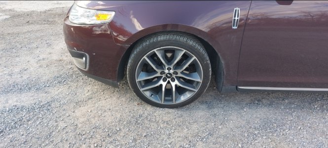

I picked up a set of 2020 Mustang rims (20 ×9 +42mm). The rims I have been using had a lower offset than stock (+35mm). I wasn't liking the steering feedback and slight vibration with new rims. I ended up having to change both rear wheel bearings. Apparently the change in offse didn't agree with them.
The Mustang rings have a 3 millimetre more of + tire offset than stock. There's a much better on Center feel. They came with Bridgestone proxus 980 all seasons. 265 30 R20.

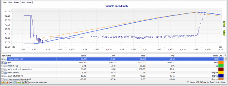

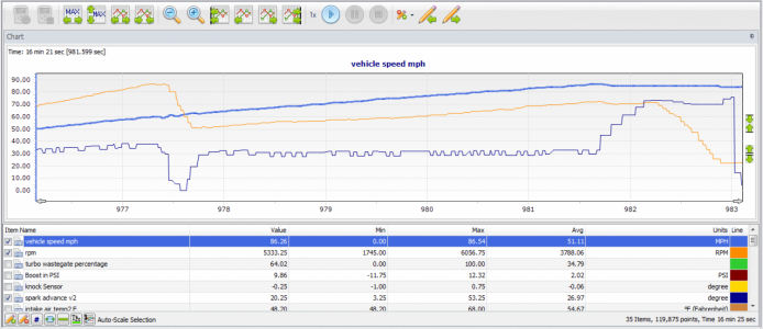

Okay I switched over to the 160 degree thermostat. At the same time also performed a drain and fill of 5 l of Motorcraft ulv transmission fluid.
I was curious as to how much ignition timing I had picked up. I made a comparison to an old log on my Livewire. Admittedly the weather conditions were different, but it was showing about 4 degrees more total ignition advance with the lower temperature thermostat.
Intake temperatures we're exactly the same at the start of the run. Intake air temperature finished 10 F degrees lower with the new thermostat. Which should result in about a 1.85% increase in air density, plus 4° increase in timing. So, optimistically, maybe 6-10 extra hp @ 34° F ambient test temperature. Both 87 octane tune, Oct 25, 2021 ambient 38°F 94 octane possibility winter gas, Mar 11, 2022 ambient 34°F 50-50 87-94 octane winter fuel mix.
What I also noticed, was that the engine RPM@MPH was lower at the same speed with the Ford ULV transmission fluid added. Roughly 200 RPM @ 3rd gear. Interesting result.Capture old thermCapture rpm new therm

Are you able to repost these pictures with the cursor present and at the same RPM? I'm curious what's up with the spark swing you have, and if you can highlight the spark advance as well, what is the delta between the peaks and valleys in your graph? Also what is your OAR in each pull?
It's kind of hard to do a screenshot with the cursor in use to do the screenshot. LOL
The runs are different, meaning that one was a third gear pull and the other was a 0 to 80 mph with 3rd gear highlighted.
Give me a few minutes and I will attached the log files to this post.
What info would you like? How much the swing is on spark timing Etc. Are you able to read the logs from the live wire? I didn't realize that was a problem and thought it was just a normal adjustment. I prefer a nice smooth line but that's what I got.

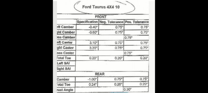

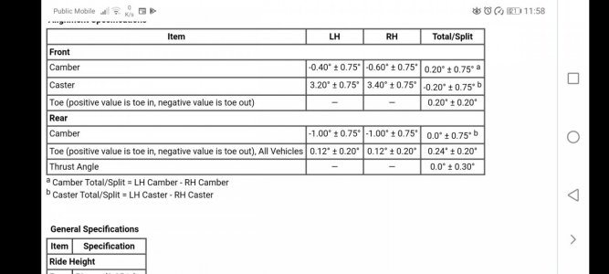

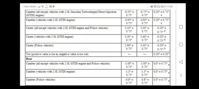

Will tomorrow my MKS is going to the shop for an updated alignment. I was looking at the alignment specs and noticed that the 2013 up Lincoln Taurus twins had slightly different alignment specs. I like the looks of the new alignment settings. Slightly more camber in the front and even camber side to side in the rear. Plus front toe is reduced. I think this will reduce drag and might provide a better drag strip launch.Screenshot 20220323 185309 PhotosScreenshot 20220323 185256 PhotosScreenshot 20220321 163235 Photos

Okay the cars out of the shop and much happier with the way it handles and steers with the updated steering specs.

When you factor in the oscillations there's about a 3 degree difference in timing, 2 of which are directly attributable to the difference in OAR (.58 vs .92).
"prt sc" or print screen copies your entire screen to your clipboard. windows key + shift + S brings up a cropping tool to screenshot a selected area of your screen. Only the first method preserves the cursor line in Livelink. Unfortunately Livelink's junk scaling makes it pretty much useless for trying to convey multiple pieces of information visually.
