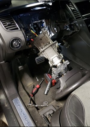

I went in and changed them both again. I can't remember off hand. The upper one I feel is the mode door... But again, cluster out, steering column lowered, pain in the ass.

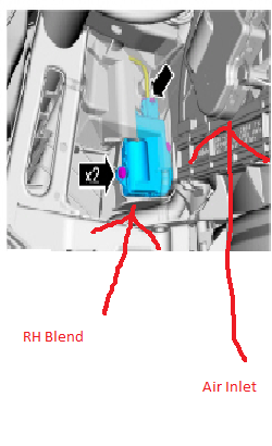

Left side upper is mode actuator. Left side lower is LH blend actuator. Right side above cabin air filter is air inlet actuator. Right side to the left of air inlet actuator is RH blend actuator.

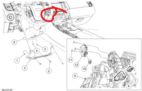

I guess the ask is where on the driver side do you go to get to it? Looks like knee panel - steering column metal - all off - then off to the center dash I take it?

Just please have fun.... Once you find the lower one.. Look straight up.. It's waaay up there.
I lost a 8mm swivel socket somewhere in there and just let er be... RIP.View attachment 88255
Wait - seriously - for a maintenance item that has a high failure rate - WTF - this whole thing made my a-hole pucker. Look I can get dirty with the best of ya - but you need to take all that apart for a mechanical item failure?

Which one? The LH blend actuator can be accessed from under the dash. No need to disassemble the dash. The mode actuator is near the top of the dash. Much more involved.
